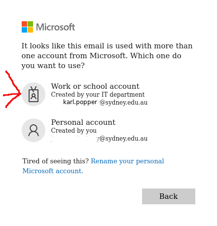

At this point Firefox (or Google Chrome) should open on the Office365 login page.
office365 login page

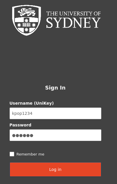

Selecting your Work or school account should take your to your Unikey login page
unikey login page

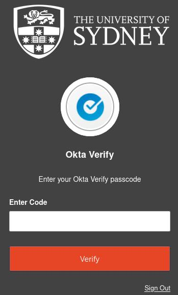

then to the Okta (2FA) page
okta 2FA page
