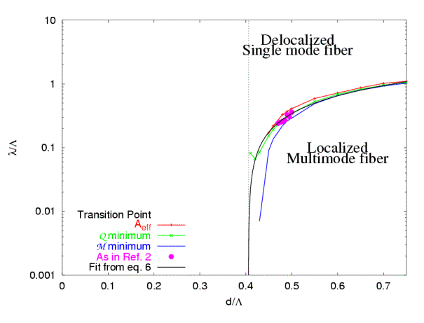

FIG. 4: Phase diagram of the second mode. The different curves  correspond to different definitions of the transition point. In the lower region the second mode is confined and the fiber is therefore dual moded. The dashed vertical line shows the approximation to the limit of the endlessly single mode regime.
