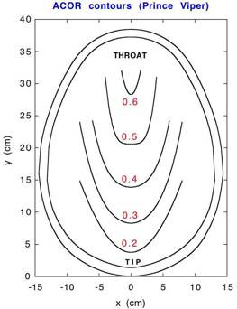

ACOR contours for two different
racquets are shown below. The Prince Viper racquet is a particularly stiff
racquet so the ACOR near the tip is relatively high, despite it being a
relatively light racquet. The ball bounces best near the throat region of a
racquet and worst near the tip and around the frame of a racquet. Measurements
close to the frame cannot be made since the ball would hit the frame at such
impact points. ACOR contours are NOT concentric circles as often shown in
advertising brochures. The ball speed off a moving racquet depends on both the
ACOR and the speed of the racquet. Since the tip travels faster than the
throat, the outgoing ball speed is a maximum for an impact point that depends
on (a) the ACOR contours (b) the speed of the incoming ball and (c) the speed
of the racquet. The ACOR contours here represent outgoing ball speed divided by
incoming ball speed for a case where the racquet speed is initially zero.
