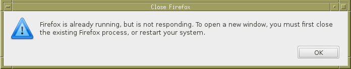

Firefox Issues
Firefox is already running, but not responding…
The following dialog displayed when attempting to start Firefox:
firefox already running
This normally indicates that a Firefox process on another machine has run and exited without removing its lock or is still running with the lock in place.
Normally when the second instance of Firefox is started it looks at this lock and locates the first instance. If this second instance can contact the first instance (using the current X11 DISPLAY environment variable) it passes the user's request (URL) to the first instance and exits. If the second instance can not contact the first the error dialog (above) is displayed.
The first instance can be located using the lock file, which is actually a symbolic link containing the IP address of the host on which it is running and its process id (PID).
This lock file is created in the profile directory under the directory .mozilla/firefox found in your home directory.
The profile directory is normally automatically (randomly) generated and looks something like emopobk6.default. Normally you won't have more than one profile but if you do then one method of finding all the locks is:
	cd ~/.mozilla/firefox
	find . -type l -name lock -ls
The output is typically
8983    0 lrwxrwxrwx   1 kpopper phil  19 Sep 19 14:34 ./emopobk6.default/lock -> 129.78.129.25:+1096
The 129.78.129.25 indicates the process is or was running on gateway.physics.usyd.edu.au and the 1096 indicates it is or was process 1096.
In this case logging into Gateway and running
	ps -p 1096 -f
will indicate whether Firefox is still running or not. If it is not running then the lock can be removed with rm otherwise the Firefox process may be terminated with the kill command.

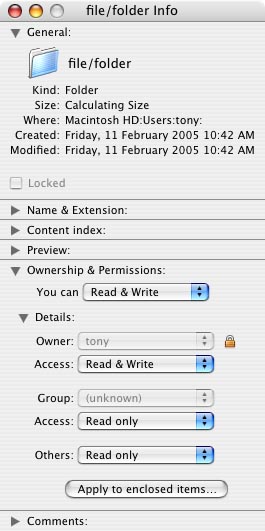

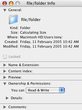

Changing Permissions on Files and Folders
If you wish to change file permissions on Mac files, either on your local hard disc or on a mounted volume (such as suphys2) to prevent or allow other users to read or write to these files or folders follow this proceedure.
Highlight the file/folder icon by clicking on it once, then go to the file drop down menu and select "get info" (note: you can also use the key combination Cmd-I), under "ownership and permissions" select "details". The permissions are set up under three categories, owner, group and others. You can then choose to allow any of these to be able to "Read and Write", "Read Only", "Write only (drop box)" or "No Access". The meanings should be obvious. Do not click the "Apply to enclosed items..." button.
You are the owner, the group depends on how many users are in a particular group and others is everybody. You may also change the owner and group by clicking on the icon indicating these values. Then simple close the get info window and the permissions will have been set. You may need to click once on the small padlock icon next to the owner's name to allow you to authenticate with your macintosh password (not your email password).

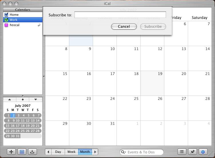

Subscribing to a published iCal Calendar
For example http://macphys.physics.usyd.edu.au/admin/export.ics
and click the "Subscribe" button. A new dialogue will appear asking if you
would like to name the calendar "export". allow this and a new calendar called
export will appear on your ical window.
